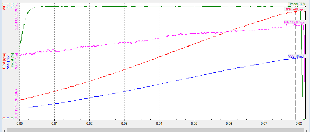

Tighten the belt.
This is how your boost should look, constantly rising till redline. Mine started at 3psi and ended at around 12psi.
