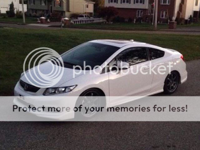

9th gen civic front end comes in 4 different configurations..
#1) asian front bumper (aka: type-s)
#2) 2012~2013 usdm civic coupe front bumper
#3) 2012 usdm civic sedan front bumper
#4) 2013 usdm civic sedan front bumper
i just recently confirmed all 4 bumpers are interchangeable
fig's 2012 sedan with coupe front bumper
robsbp's 2012 sedan with asian front bumper

The hood of 2013 sedan is about an inch longer in the front. That is just about it. If coupe front bumper fit 2013 sedan then that means 2012 and 2013 sedan front bumper are interchangeable.

Fig did HFP rear lip on his sedan. It looks really nice!
Ah, is that the HFP side skirts as well?
Wonder if someone can take a shot from the side profile to see how much it protrudes outwards.
