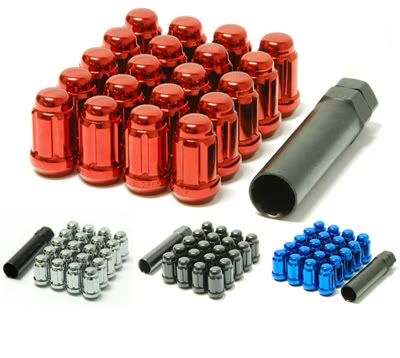

Lug nut size is 12 X 1.5MM .... Spline drive wheels are the old knockoff type wheel... so no they aren't spline drive. But there is a style of spline drive lug nut.
Also if your going OEM wheels the lug nut is spherical and most aftermarker are conical. They are not compatible with each other.
SEAT TYPE: There are three main wheel nut / wheel bolt seating types, 60 Degrees Taper Cone, Radius Seat or Flat Seat. In the diagram below you can see these different bolts seating types. The correct nut / bolt seating type is required to ensure that the new nut or bolt seats correctly in your alloy wheel.

Opinion please, I have a 2012 Civic SI Coupe ASM, all stock except 5% tint, I'm wanting to put black lug nuts on with my stock wheels, do you all think it would look good? Thanks in advance.:)
2,289 Posts
His car is ASM aka silver. You can find these lugs (at what I consider a fairly decent price) on eBay. Just make sure what you buy (if for OEM wheels) is a ball seat lug.
I think they would look good, I was considering the red ones myself. But I think I'm gonna get "the system" by Gorilla. Lol
