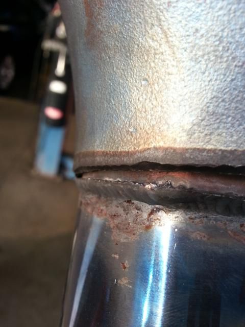

I'm really wanting to pull the trigger on this downpipe but i found this picture the other day and it worried me. Does it come with any kind of warranty?
full race down pip, cracked & looks rusted...
skunk down pipe cracked and look rusted
crack in the welding point may happen if the car is running lean, you just need to make sure the vendor (you purchase from) & manufacturing will take care of it...
