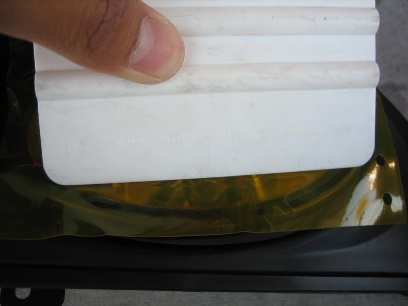

STEP 6: Use a credit card to get the bubbles out. Example below
