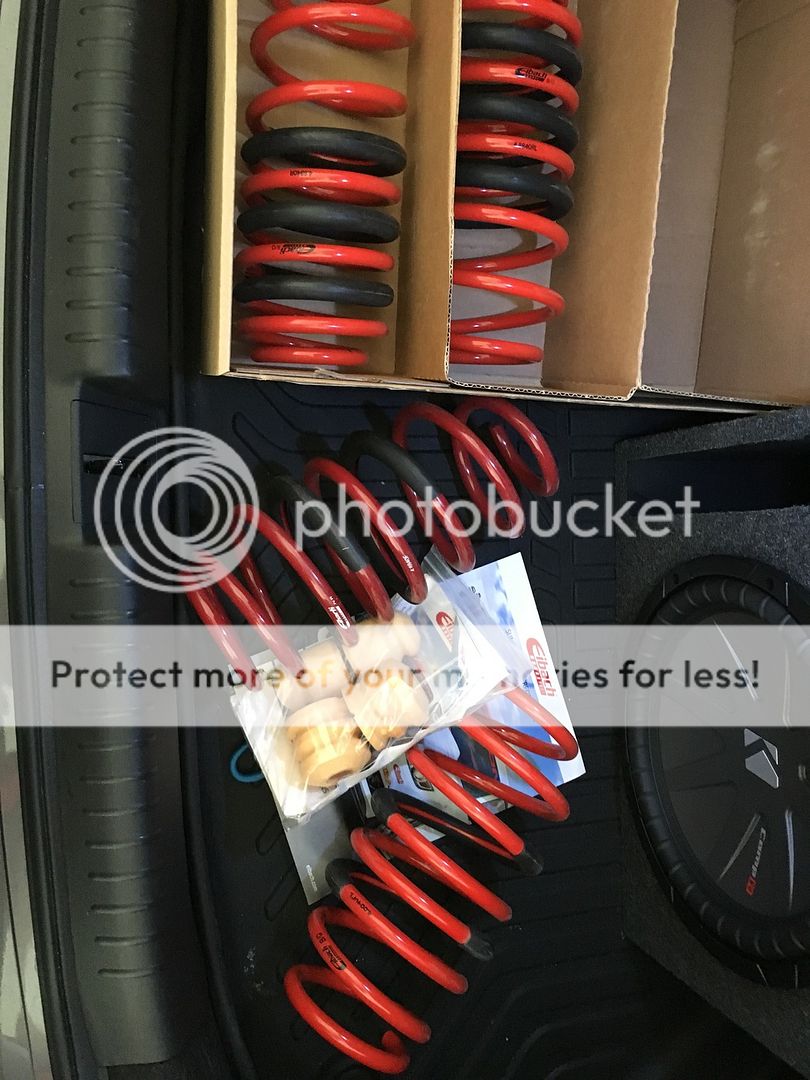

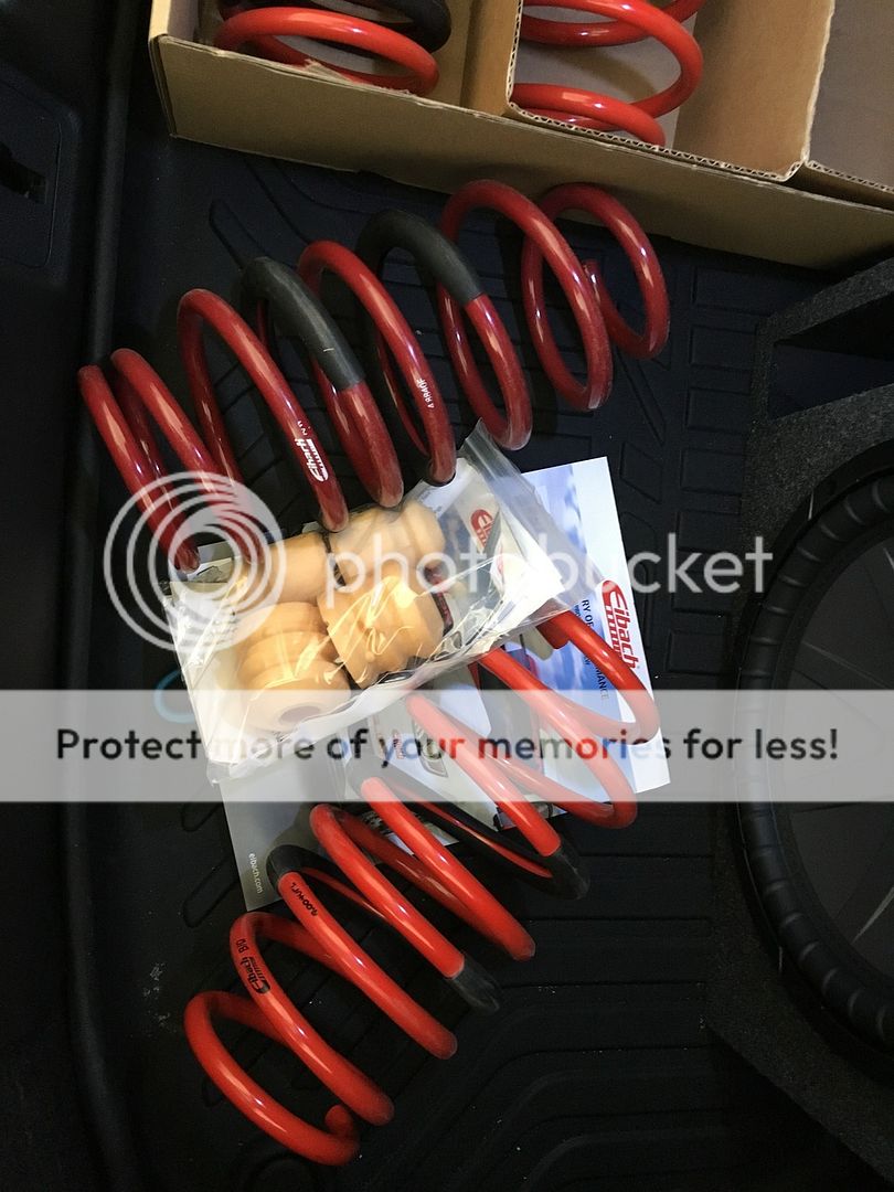

I have a question, I just got my eibach sportlines for my 2015 Si sedan.. I got them from @PRO Civic and noticed that the FR Spring is a darker (maroon) red color compared to the rest of the springs and the letters on it are white vs the black on all the rest... Why is that? Also does bump stops that come with it do I need to install them?
