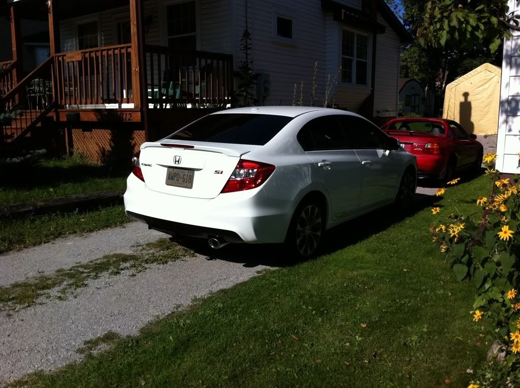

Spent some time googling it up. Found a few hitches for the 2012 DX/LX/EX models 2 and 4 doors, but most specify 'except Si'. I called my local shop that installs hitches and they say they have found one that will work. Picking it up on Monday. Hope it looks okay.
Should have pics of hitch installed on the '12 Si 4dr by next week for you folks.
Need it to get my toys around.. Used to use my 8th Gen all the time for that stuff.

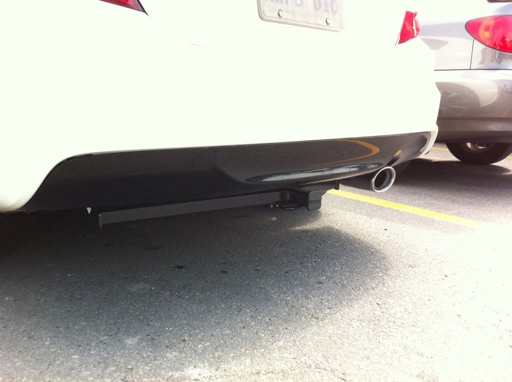

Hardly noticeable in most light thanks to black on bumper. Draw-tite Sportframe hitch. The part number is the same for the 2011 Civic Si Sedan. Fit without a problem. Part # 24763 I think.
Got rid of the Draw-tite/Curt hitch cover and ordered honda part # 08L92-S9A-10016

Did you have to remove the rear under cover? Or were you able to trim it?
312 Posts
Panel remains on the car, with 2 small slices cut into it. Nothing catastrophic or shade-tree looking. Its actually a really clean install.
