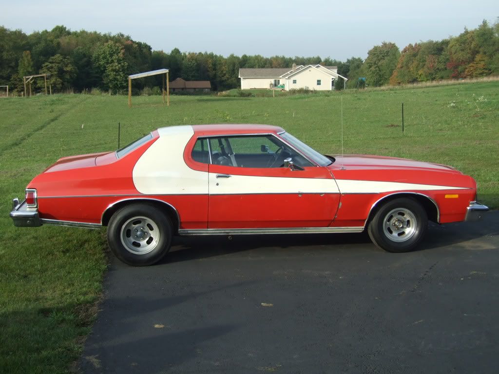

Hey, starsky, I see that you've been here several months, but let me welcome you to the site, anyway.
I've been considering a new paint job for my car. How do you like this?
Sorry, couldn't resist. haha
