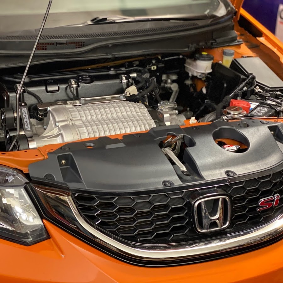

MercRacing Aftercooler Upgrades:
We might call this stage 2 cooling upgrades. Bigger water pump, and bigger heat exchanger.
Called it! New parts were the reason you took off your bumper.

LOL. This heat exchanger upgrade is "highly experimental" but so far very happy with the results.
