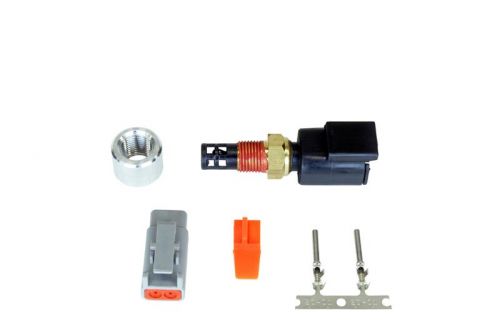

What are your IAT's normally? I noticed that mine seem to be kind of high with my turbo setup, almost wonder if its a bad sensor or maybe I just need a bigger intercooler.
it really depends on a number of things. But on tract my IATs never went above 117 after 12 laps. Those numbers I’m happy with.
In a traffic jam on a hot day they can go up as high as 140, but I don’t load the car up until they drop again.
Recovery is key a good system will start to recover as soon as the car starts to get some air through it.
My OBD1 style sensor reads high, if that's what ya got. I confirmed by checking IAT readings on the engine cold, in the morning, was always much hotter than ambient. Putting a AEM IAT sensor in, just gotta get the hung welded in.

I am using the AEM IAT sensor.

I confirmed that my OBD1 style was bad because I noticed that after plugging my flashpro in after the car sat overnight, my IAT was reading 105 when the ambient temp was reading 65 in my garage. I got a new OBD1 sensor that I'm going to try out, hopefully it works. If not, I guess I will try the AEM.
Are you on a s/c or turbo setup?

I would only trust the AEM style IAT. There's another company that makes another, but it might be the same.
I put the new obd1 style in today and it reads just as high as the old one. I'm going to try shaving the plastic down that surrounds the probe, hopefully it works better. Just sucks because we've been getting temps in the 40's but my iat sensor seems to think it's 105* out lol.
Why not just go with this one:
Honestly I would not rely on the ODB1 one for reliable information. Those sensors if they read accurately, they don't read changes fast enough.
I was gonna shave mine, but decided to use the AEM. Not sure why all the turbo kits use the OBD1 style.
Be careful, it may effect your tune.
it will most def effect your tune. There are IAT compensation tables to retard ignition at high temps. So either your car constantly will run in retard mode, or perhaps not retard when needed, which can be dangerous. For $50 you save yourself a lot of grief.
53 Posts
This is why i think your safe to shave the OBD1, your just making it react faster to change, not changing the offset reading. Old forums have alot of info on this.
If i wasn't going to retune, I'd shave mine. Since I'm retuning, I'm upgrading to AEM.
