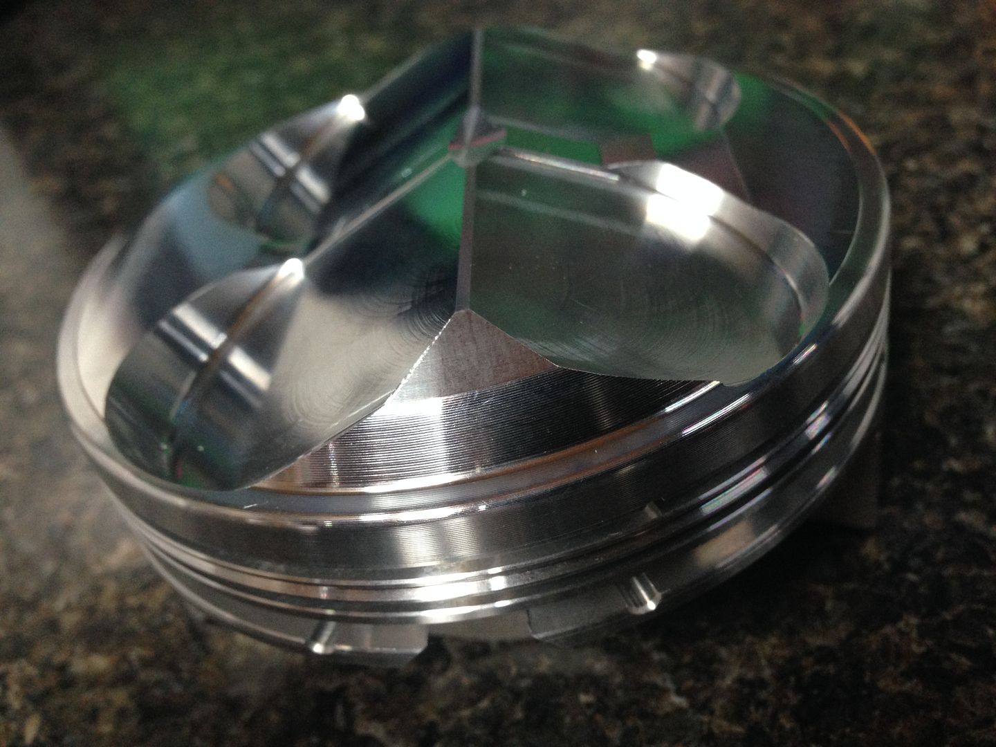

building a 106 stroke k24 for this season. will be 2697cc's. will make some more hp up top but the mid range is going to be the big difference.
BC crank I presume on the duece.?
Question is,who's making the crank on the 24?custom PistonS?I don't know of anyone making readily available 89.75 pistons.pretty high cr regardless.almost 14 if memory serves right.diesel territory.

the piston is 90mm. It's a custom piston only available through Prayoonto. It's 16:1+ with the 106. The head chamber is modified via cnc for max compression
Yes bc crank. The 106 crank is BC also. Its a special material forging
Big difference other than displacement with the new motor is it will have aluminum rods instead of steel. About 80 grams lighter per rod.

Wth?billet rods?lol damn you trying to rev to 15k?
I was going to say a 90 mm piston would put you over 2.7
But if your recessing the piston in the head then I see it now.oversized valves probably too?.

106x90 is 2697 cc's
i have a 4 speed straight cut dog engagement PPG transmission. yes it has oversized valves. my cyl head flows about 380cfm.
the rods are aluminum to save weight. same with why the piston looks the way it does. every gram = power. if i had 3000 for a carbon clutch and aluminum flywheel that would free up more power compared to the standard steel flywheel and ceramic discs most people use.

In All motor manual/sequential trans will always be king. Look at pro stock Nhra. Every hp counts. A torque converter eats hp for breakfast
big thing to shoot your post down is none of that is allowed in my class. Oem trans case must be utilized.
The 8 sec pro stock all motor class can use a sequential but it's a weight penalty. A cheap one is like 15k.
