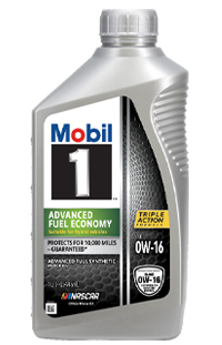

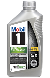

Has anyone made the switch from (SAE 0W-20) Mobil-1 Advanced Fuel Economy Fully Synthetic Oil to (SAE 0W-16) Mobil-1 Advanced Fuel Economy Fully Synthetic Ultra-Low Viscosity Oil and noticed an increase in fuel millage MPG?
The ILSAC GF-6 was split into two subcategories: GF-6A and GF-6B. The principal difference between the two subcategories of oils concerns viscosity grade and high temperature, high shear (HTHS) performance. The ILSAC GF-6B grade will provide the same performance as GF-6A, but with the added aim of lower HTHS to deliver potential further fuel economy benefits and the ILSAC GF-6B will be defined for 0W-16 viscosity grade oils only.
They state ILSAC GF-6A is backward compatible, while ILSAC GF-6B will not be backward compatible for older applications and features an entirely new formulation. In addition to GF-6B’s lower viscosity, a unique balance of additives, viscosity modifiers and base oils will work with new and unique engine designs to maximize fuel economy.
No, not us. Every Honda / Acura we own or maintain uses “20” for the operating temperature viscosity … so we’re staying with that.
in this case, I'd go with the Honda engineers.
Me, too.
Yeah let Honda do the experimenting rather than experimenting on your own car just stick with what Honda saids works best IMO.
Same here.
If we get something newer that specifies 0W16, then that’s what we’ll use.
