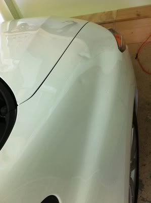

This is the hood hail damage on my car.
The depth of dents. (to our American friends, that coin we call "toonie" which is worth $2 two dollars, I guess it's about the size of your half-dollar coin). Notice in the photos I purposely captured the oorange peel (the ripple texture within the paint), this will be useful explaination later on.
