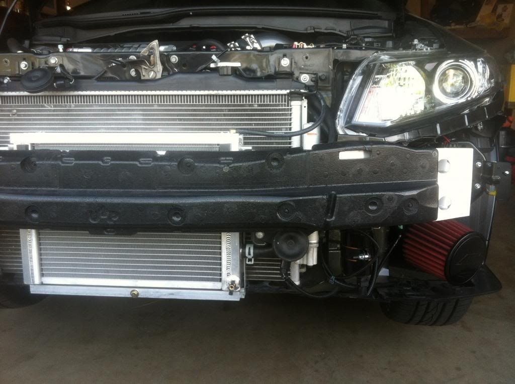

Stock Photo of CT Kit
My CT Kit w/ 3.15 pulley, DW 750cc injectors + Flashpro
Mercracing Stage 2 Aftercooler kit - as this was the first one - no brackets for the Heat Exchanger were included - they may be with future kits - please inquire if purchasing.

No mounting brackets for the heat exchanger!
So you would have to make bracket for it to connect to your crash bar like the KW kit does. Or you could have to mount under your radiator like a lot of ppl have done!

It's not bad it's just easier for Jose to make the kits faster if he doesn't make brackets. And it also makes the kits universal between coupes and sedan. The Brackets are actually pretty easy to make. And no worries about being the smartest guy. I'm not either. It just comes from trying it and making mistakes. Just learn from your mistakes and you become way more knowledgeable than you would ever think. :) so ask all the question you need that haven't been answered in the above post! Lol
