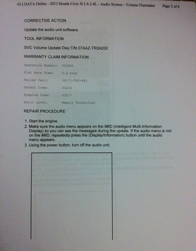

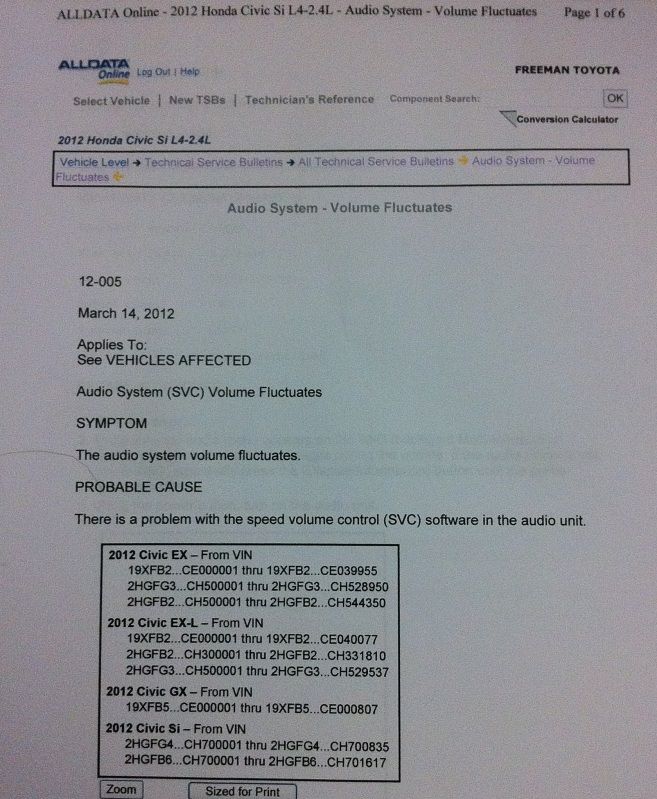

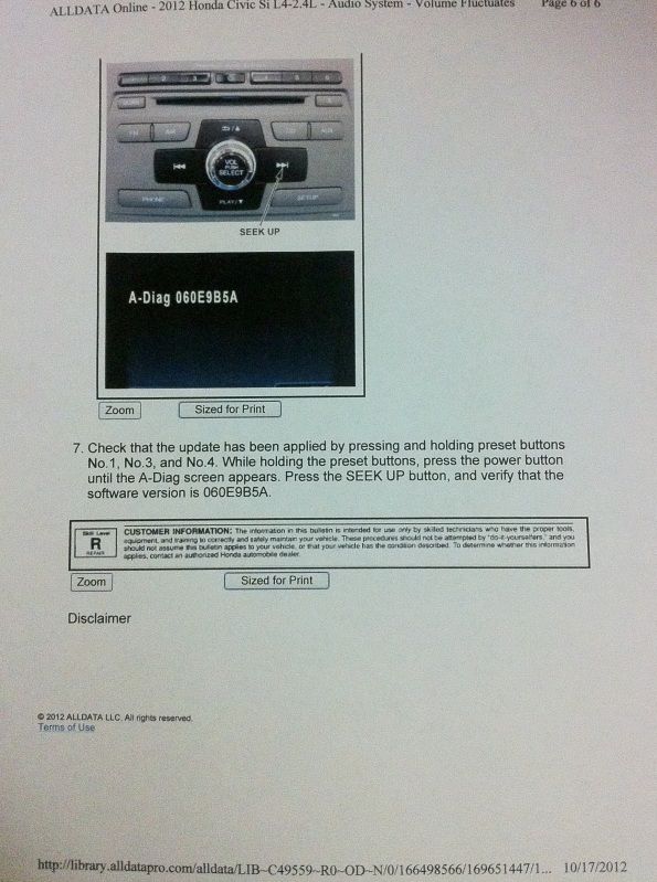

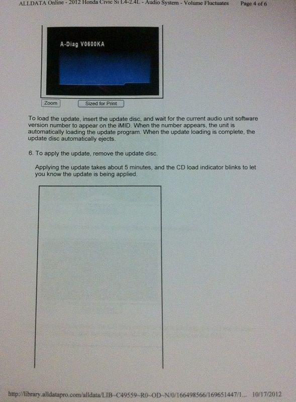

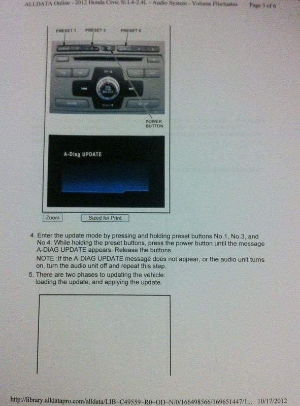

I got bored today at work and decided to look up the 2012 Civic Si on Alldata. I found 2 recalls on my 2012 Civic Si for passenger curtain air bag and drivers curtain air bag. Also found couple of TSBs.
I didnt have time to scan the pages I printed but I took pictures of it on my phone for now. I can keep you guys posted if anymore shows up. I know there some members on here that works at honda and can post up their tsb and recalls. I wanted to post this, so people who are going in for their recalls or a TSB knows what they are exactly doing.
TSB:
12-005
March 14, 2012
Audio System (SVC) Volume Fluctuates
