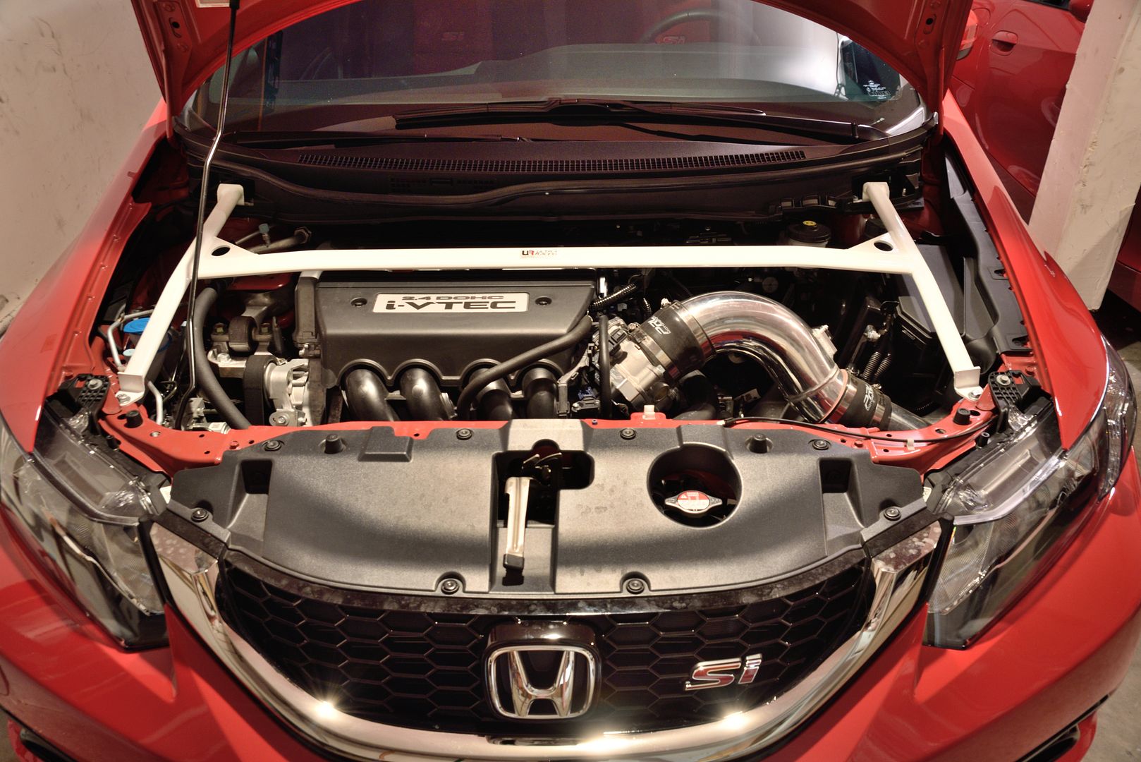

I know this is really no big deal, but in all of my web searching to find the exact connection points for this strut/chassis bar, I was able to find all of 1 single picture on Google Images, hence this post.
In order to get this thing mounted, I found it easiest just to completely disassemble the cowl that covers the front shock towers. This gives essentially unlimited access from above to the two bolt holes each, on driver and passenger sides. This way, you can get a rachet and extension in there to easily tighten everything down. Enough washers were included to use one on the top AND bottom sides for both of the front attachment points. This is what it looks like when it's done.
Team 3D is right. It actually doesn't connect at any of the bolts that hold the strut top hat to the chassis. Instead it connect inside of either strut tower. That being said, I felt a huge difference going up and down driveways, like into or out of parking lots. I haven't gone around any corners fast since the install so I can't comment on that.

Here is my 15 Si sedan with 4point strut tower brace and 3 point rear trunk brace. They work! It does what it is supposed to do! On Monday while getting my oil changed at the dealer by my buddy, I test drove a brand new 15 Si and instant difference. I was able to smash on corners and freeway and I was very happy with my car. The salesman even took it for a spin on the freeway. He has a fully built 8th gen so after he convo he was cool about me testing the car how I did :smiling_imp:

I do like the way the car feels a lot more now since the front brace is in. I was accelerating up a semi circular freeway on ramp on an incline with some camber in the right direction to help, not hurt. Damn the car just felt so right! I'm pretty excited for the rear one now.
