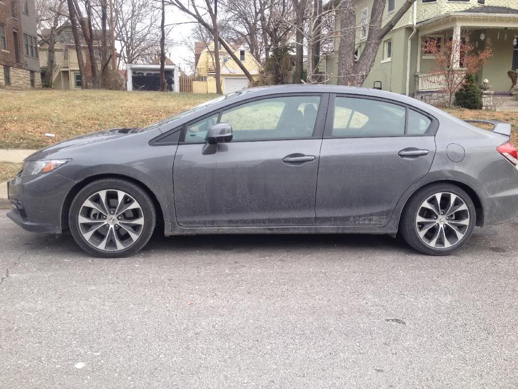

#28 ·
I have HFP on my 13 Sedan. I posted my thoughts on it in the giant HFP thread that is stickied. Paid 750 shipped and had a mechanic friend put it on for about 150. Huge improvement on handling and still a comfortable ride would be my summary. Best mod I've done to this car.
#29 ·
So the rear sits lower than front? I don't like that. If anything I want it the other way around.
Any more sedan pics?
#37 ·
View attachment 134290 View attachment 134298 View attachment 134306
Hopefully you can get an idea of my resulting drop from these pictures. It is slightly lower in the back than the front
Thanks for the pic that helps me decide. Importing the HFP kit to Canada, taxes, exchange rate, install etc etc is not cheap so I want to be 100% sure before I pull the trigger.
BTW can you comment on ride and handling especially compared to stock Si suspension thanks again.
#36 ·
Took this about a week ago. I've had HFP on since early October I believe. It's about .5-1.0 inch lower than stock. I compared it to my buddies 13 Si Sedan that is stock. If you're even mildly considering getting this suspension, do it. Major improvement.
#38 ·
Thanks for the pic that is a awesome comparo for me since my Si is PMM too. The drop is slight but definitely noticeable.
