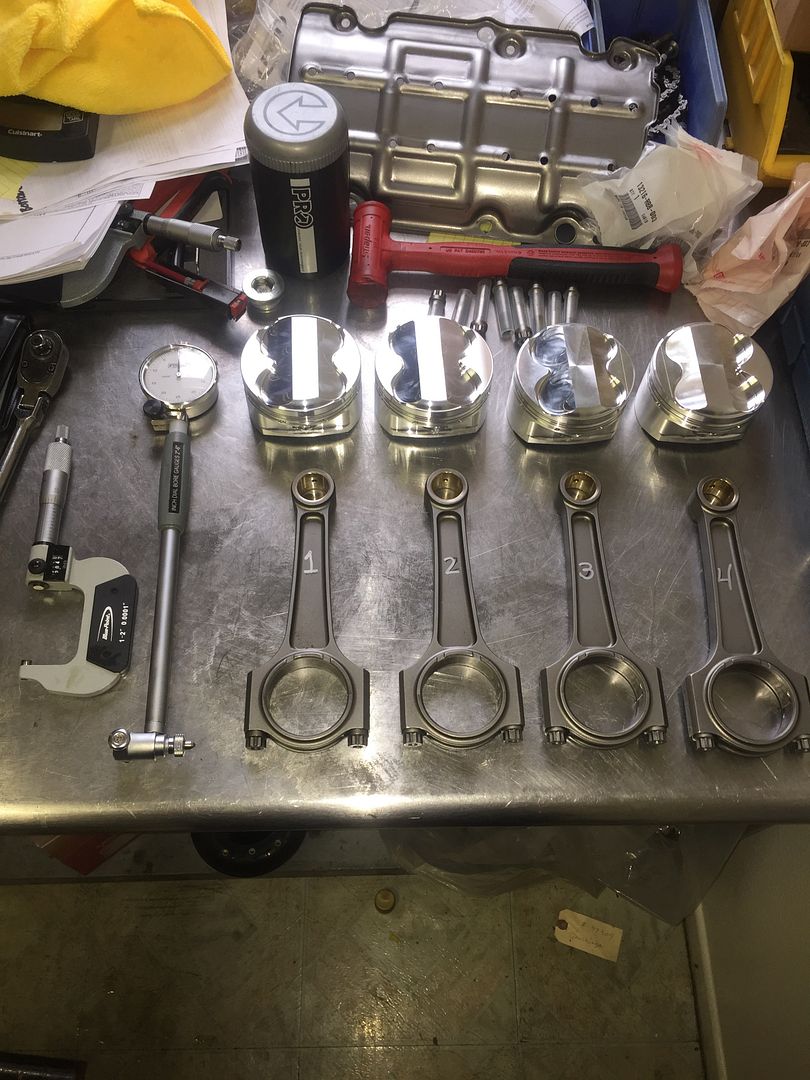

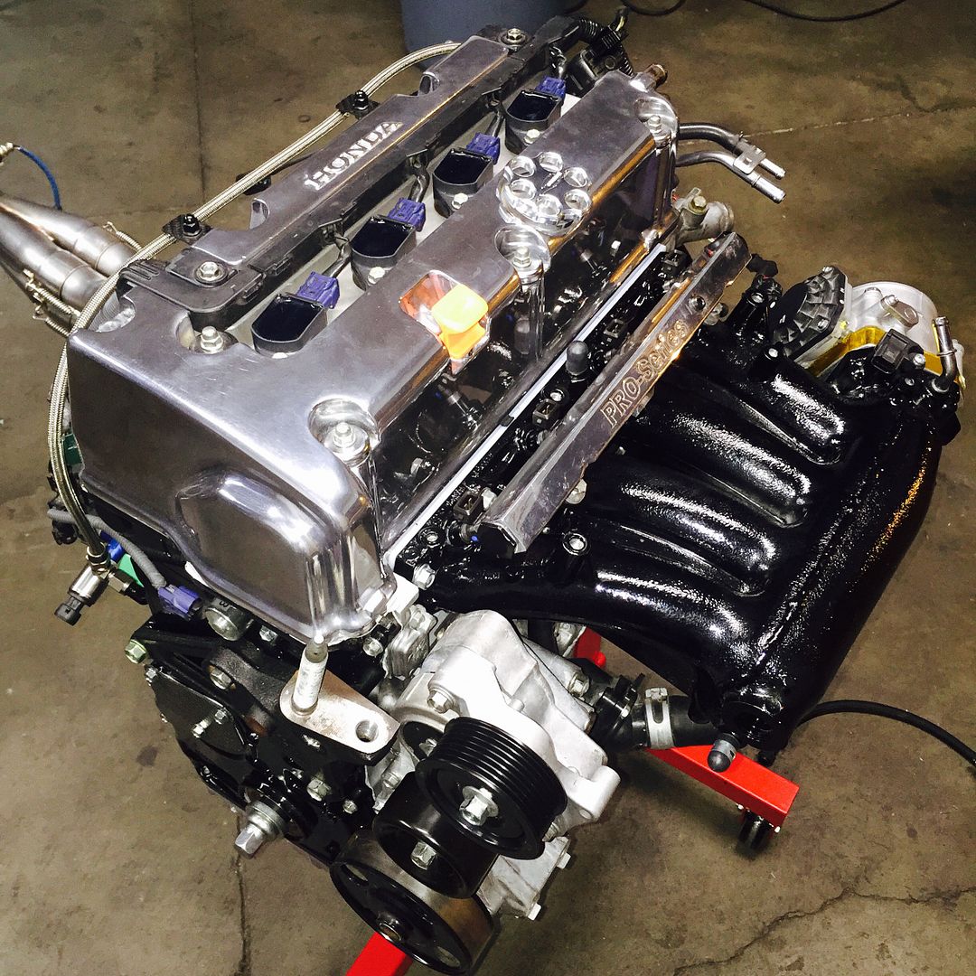

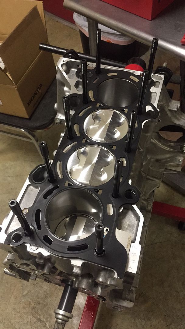

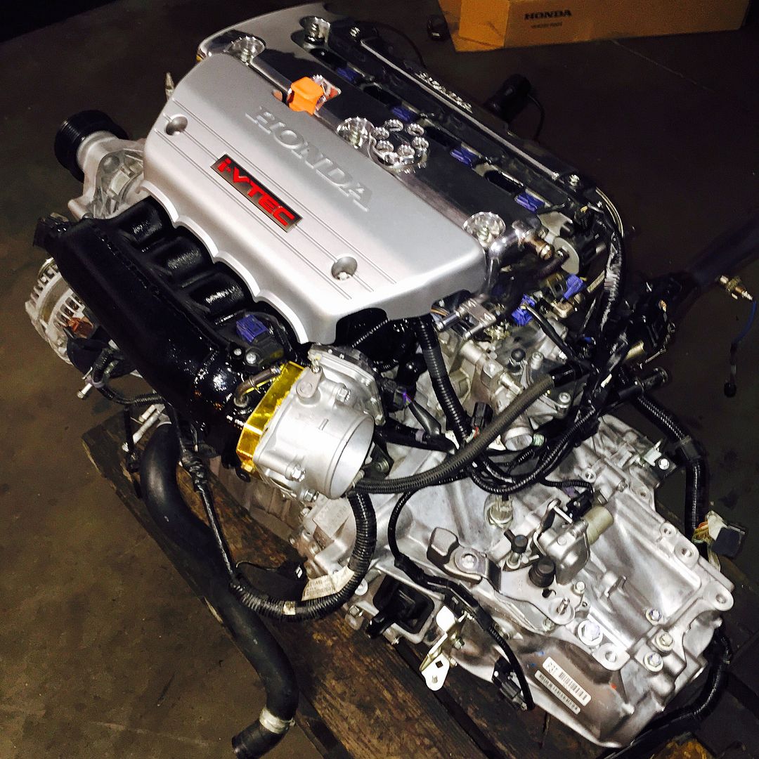

ive been working on a k20/k24 package for the 9th gen. and everyone is doing it wrong. even that turbo build with all the skunk junk. the old K20 valve cover will not seal with the front 9th gen timing cover it will spew oil as soon as it sees and run time. the HG is also an issue.
heres what ive done thus far and i think ive done it the most correct way possible. also if you ever see someone claiming they have a K20 head on their 9th with a stock 9th cover its because they are using the stock shitty intake cam the 9th comes with and a R40 VTC gear.
you are right k20z3allmotor, the 9th gen valve cover doesnt workt with the k20z3 VTC because the Valve cover doesnt clear the vtc cam bolt, we changed the bolt in the vtc and then it fits. Its just a matter of few mm less in the bolt head. we are still testing and tuning but we have 272whp and 201 torque
good luck when that slim bolt your using fails. you do realize it must be tq'ed to 87 ft lbs? not just tight, also at that point the 4 torx bit VTC bolts will scrap the case. this is not ideal and should really go about it different.
We made a a bolt at a local cnc machine shop and we used a better material so it has a higher resistance than the oem bolt. We wont have any problems there. After installing the bolt we triple check and the vtc clears the valve cover
